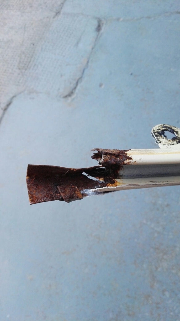

Today, we found the only corrosion present on my Sprint.
The underside of the car is like new and the rear beam axle was always going to be replaced with a galvanised item anyway but when we removed the interior side panels we found corosion around the rear windows with both winders and lifting mechanisms completely seized on both sides.
There are some plastic tubes located at the base of the mechanisms that are designed to drain away any water ingress via the rear window glass but on one side the tube has become corroded and blocked and the one on the other side isn't even connected due to rust.
The glass windows themselves slide up and down the runners OK but the lifting mechanism and the winders (regulators) need replacement.
Thankfully, I've managed to find some good useable replacements.
Onwards and upwards! :)

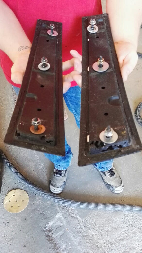

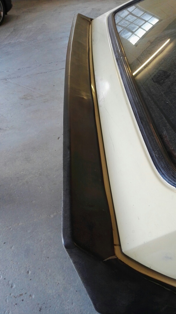

One of the unique features of the Sprint Speciale limited edition was and is the rear rubber spoiler.
As you can see from the pictures, on my car it's in pretty bad condition and quite honestly is realistically beyond saving. So, if it can be removed in one piece, I'm going to have a replica made using the original spoiler as a mould by the legendary Bob Wright: http://www.alfapanels.com.
Hopefully, the original will come off without dropping to bits. :|
Wish me luck. I think I might need it! :roll:

After much deliberation, the rear spoiler has been ever so carefully removed - thankfully intact - and this will either be repaired or, most likely, replaced with a replica item after it has been assessed at a later stage.
