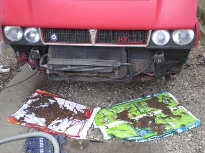

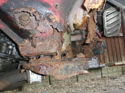

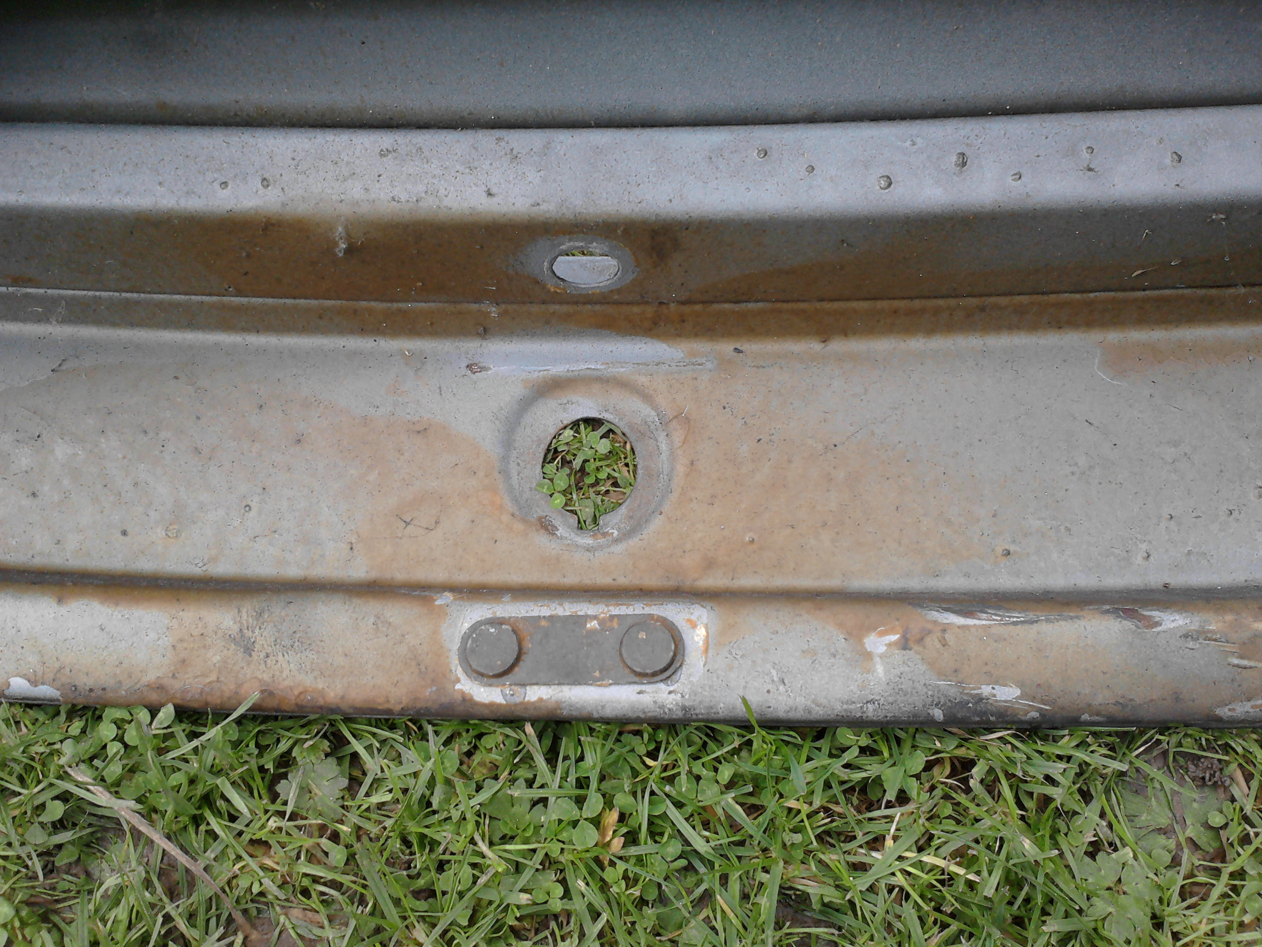

got some rust issues to sort...

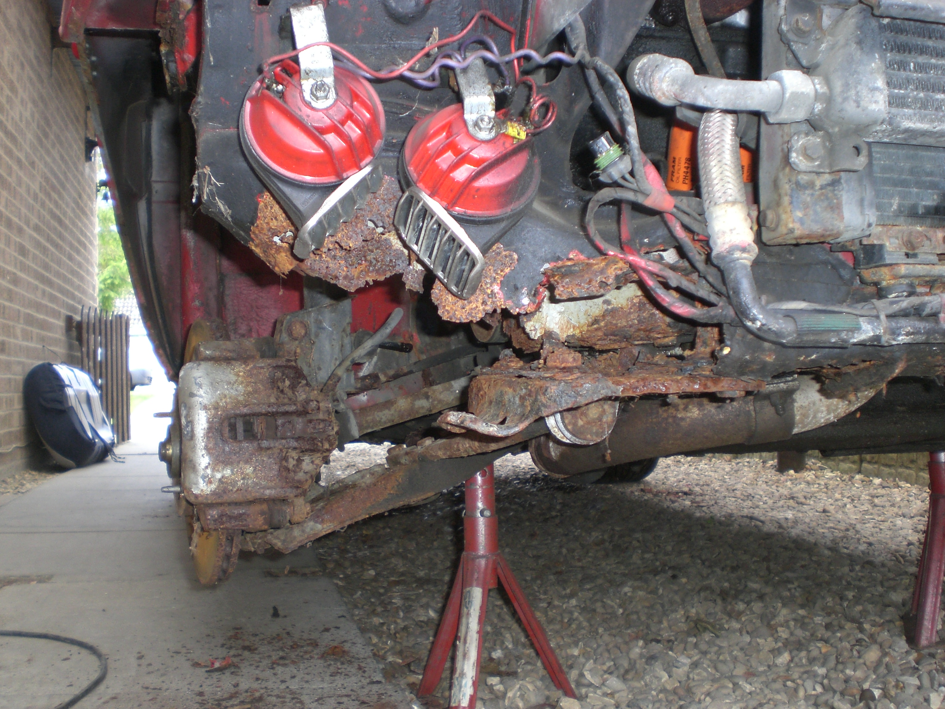

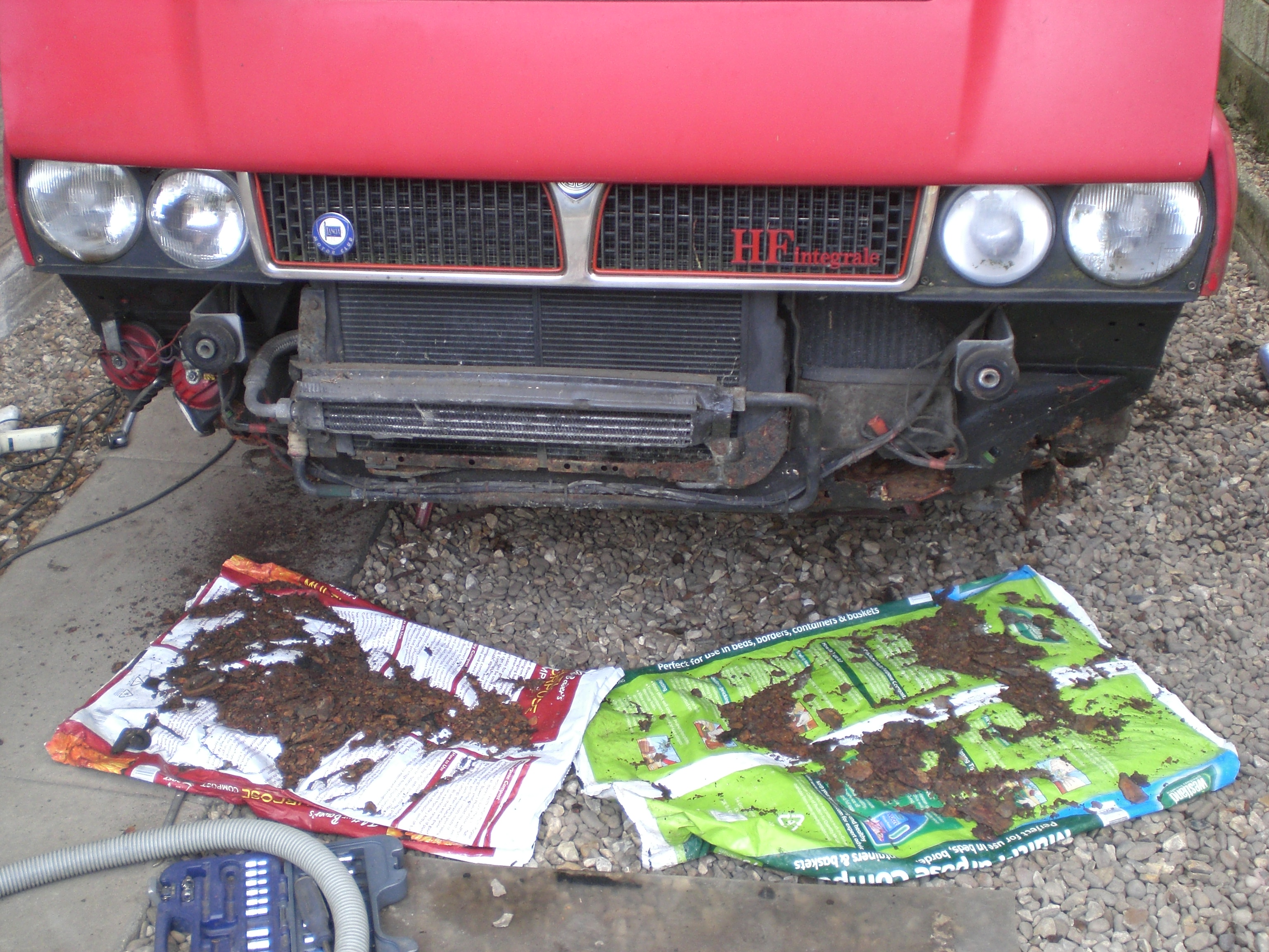

rob & me took the front bumper off today for a look at the front cross-member which we knew had soem corrosion :roll:
we had to put some plastic sacks down to collect the flakes!
think i'm gonna have to find a new part :lol:

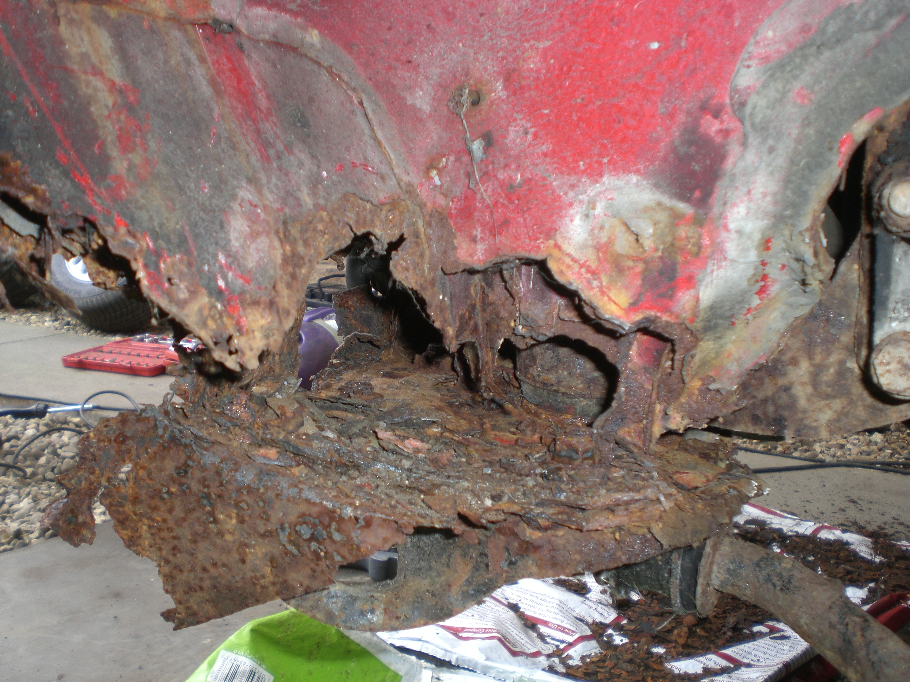

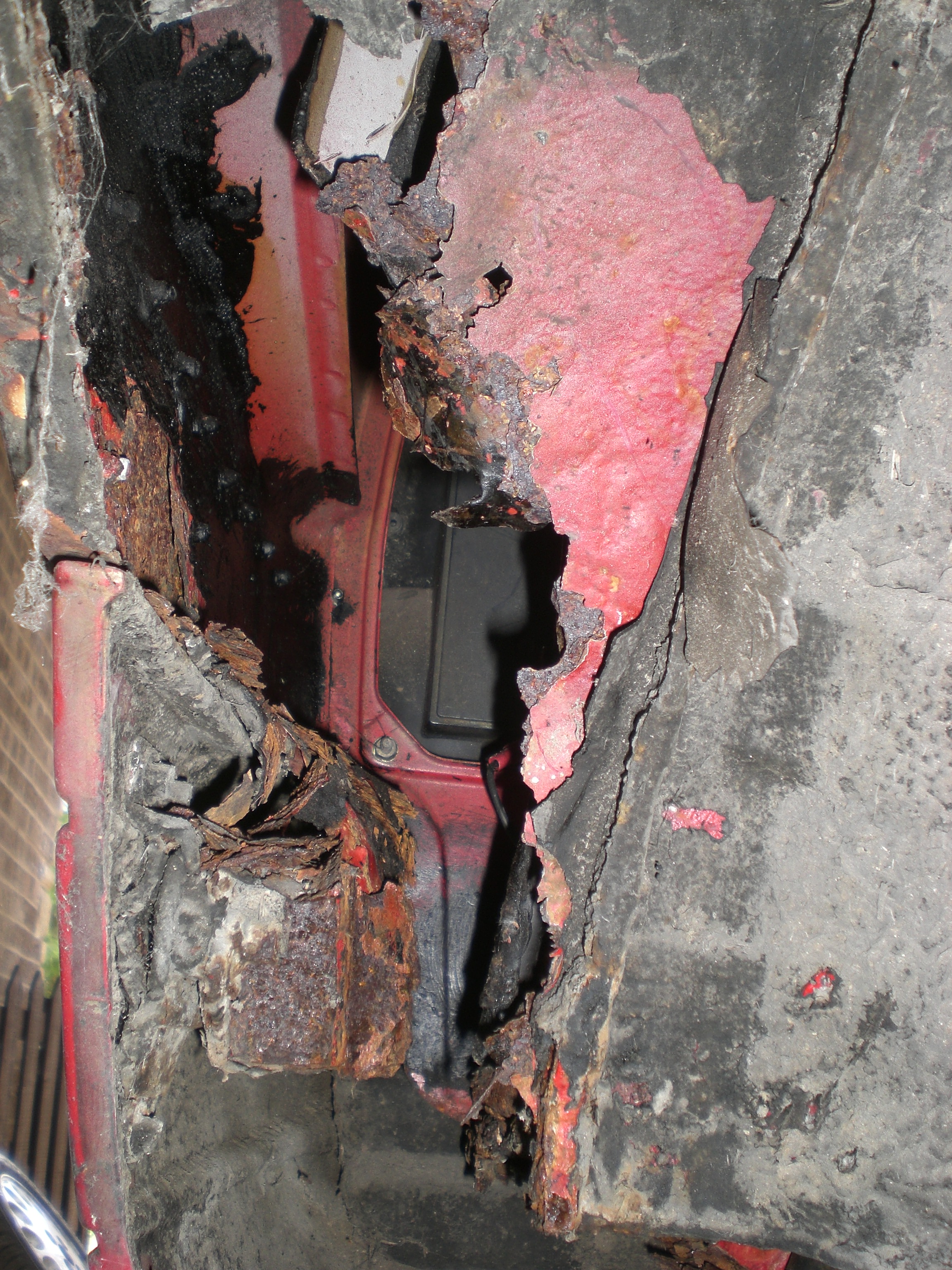

rear end wasn't much better :D

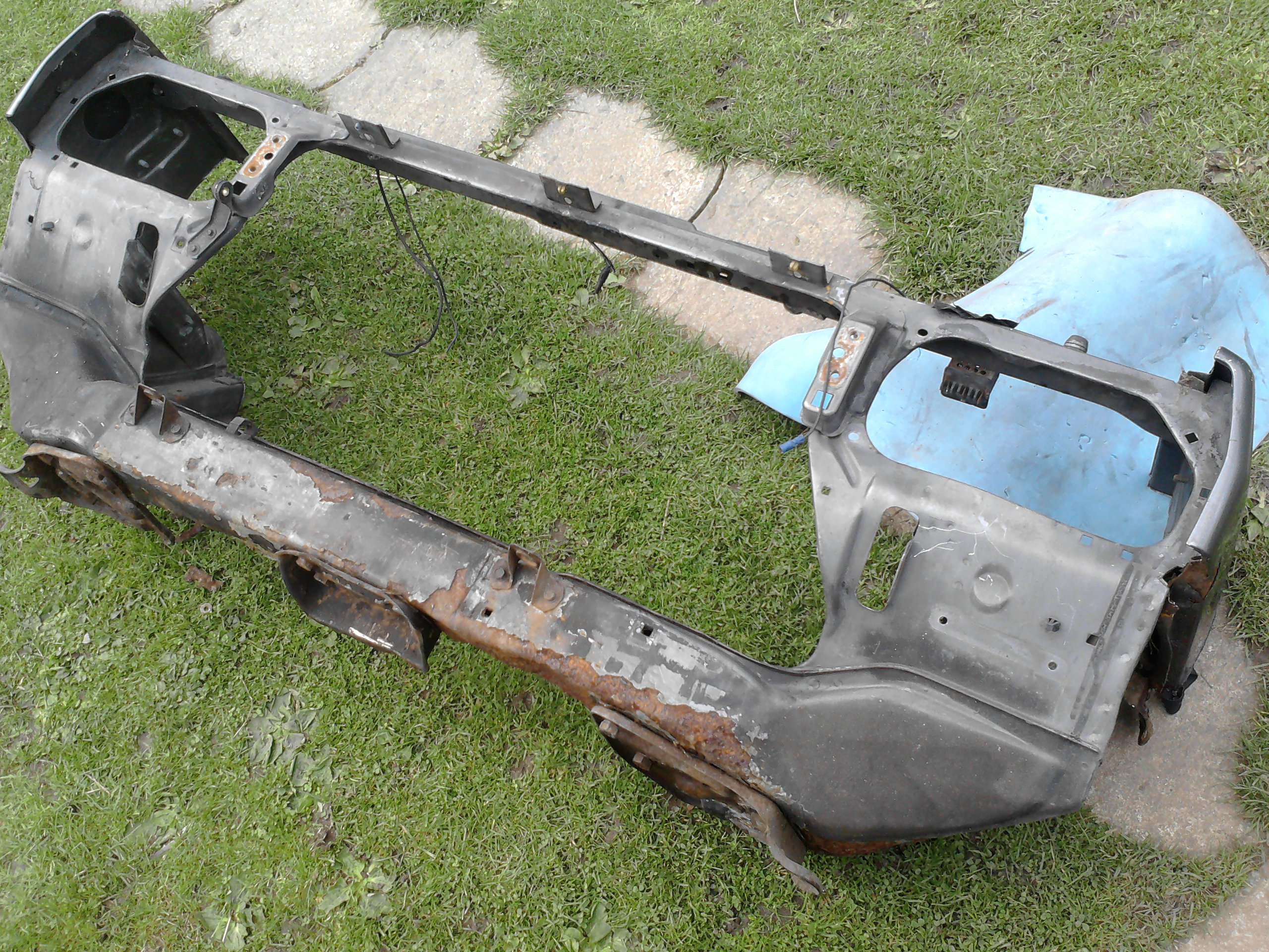

had a ride over to west brom in brum this morning to get a few bits for the car

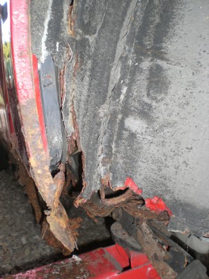

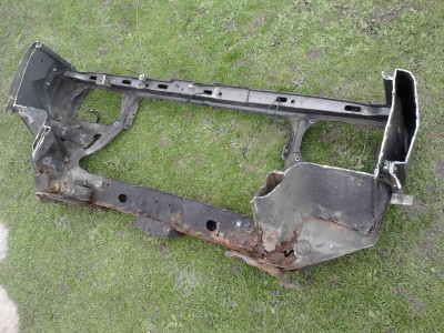

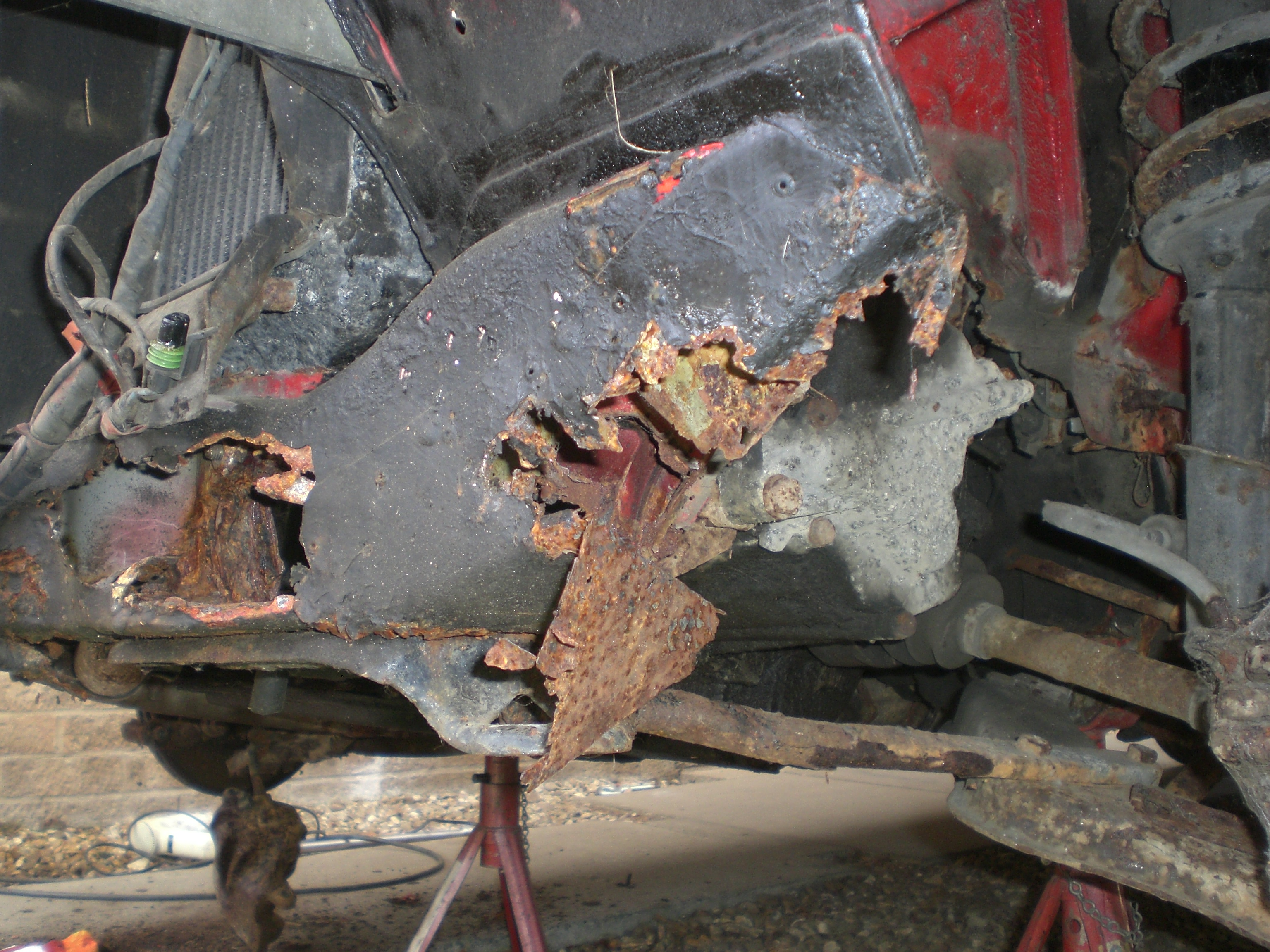

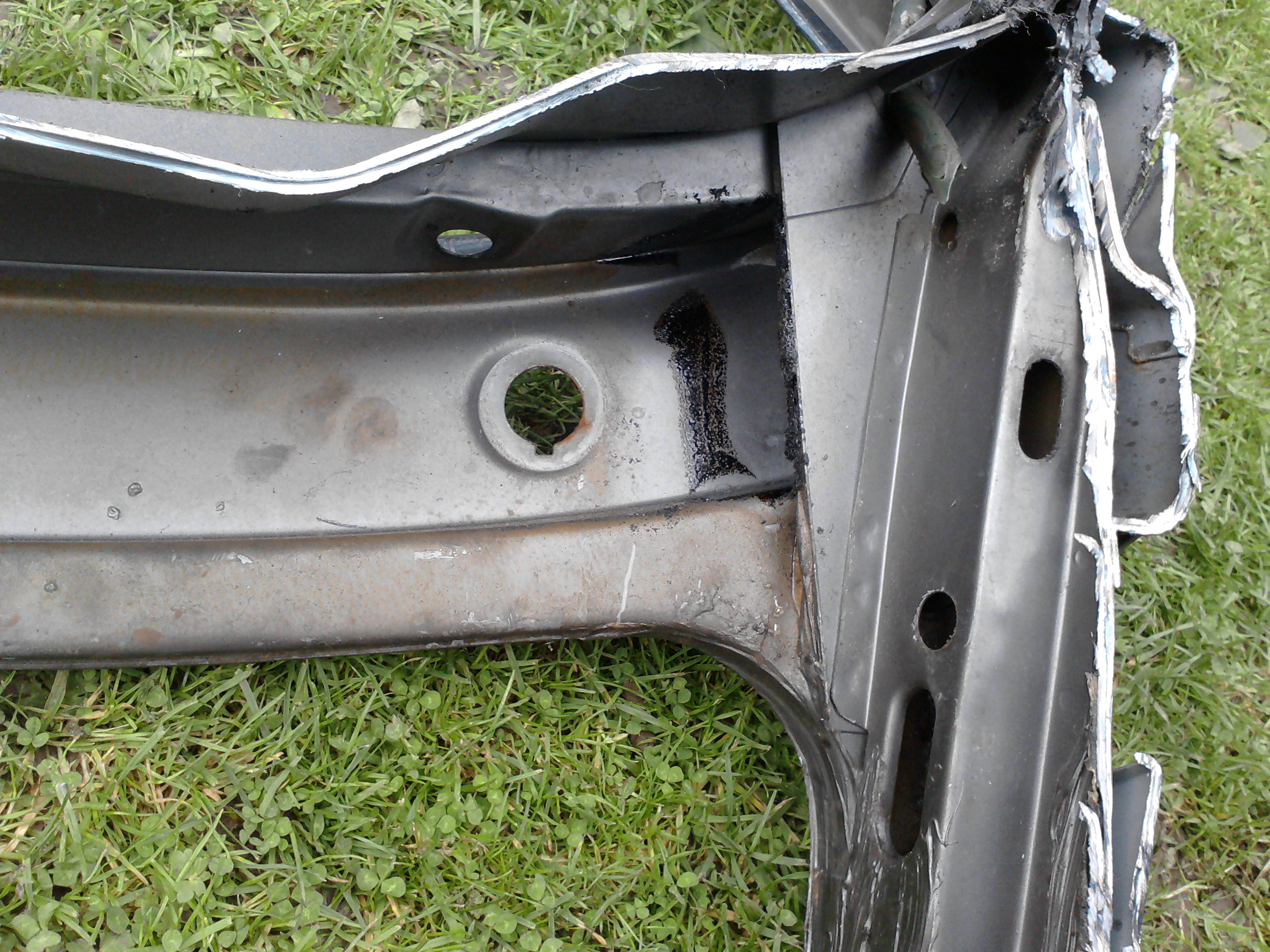

i'd searched everywhere i could think of this week to try and find a new front cross member but it seems they are just not to be found anywhere, even walkers who have probably the biggest stock of integrale parts say they haven't been available for years so a used one was the only option save for a very expensive commision on a new one being hand made. didn't fancy trying it myself....
as with most delta's this age they have rot in the corners where the road crud gathers at the tie rod mounts. most people i asked didn't have a useable cross member, or were unwilling to chop one out of a usefull shell, understanably really.
the fella in brum though breaks a few and had one that has a mostly solid cross-member but needs a little reapiring around the usual area. said i'd best coem have a look before he chops it out to see what i reckonned.
so i had a look, decided it was the only option and we chopped it all out.
top fella agreed to also leave the inner wings and chassis rails on so i can join it further up where i need to, along with the rest of the front panel should i need to
it's much more solid than it appears, although will need some mending.

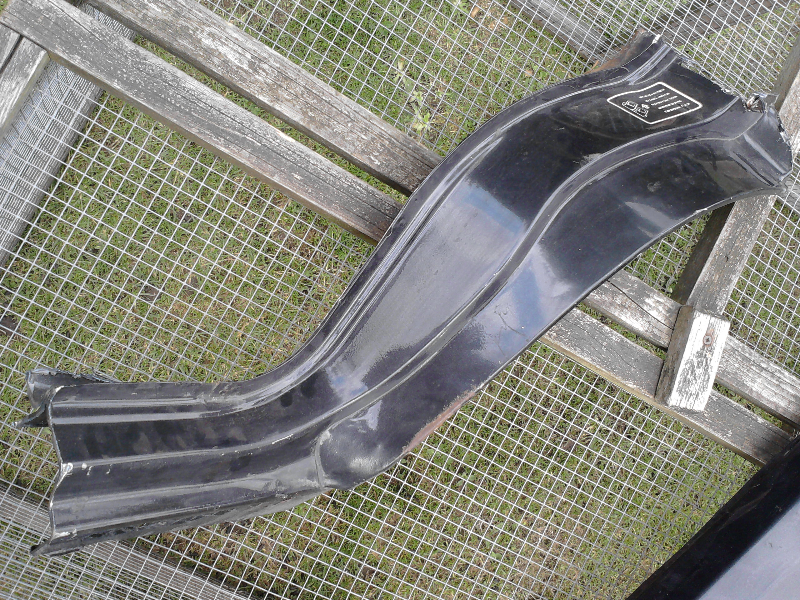

another integrale shell which is due to be crushed very soon gave up another very usefull panel to me, the n/s/r wheel arch and sill portion. he kindly cut it all out well inside the car so i can pick the panel back and then spot weld it along the door seal as per original rather than joining it along the length.
the addition of a bit of sill/step is also great as mine has rot there.

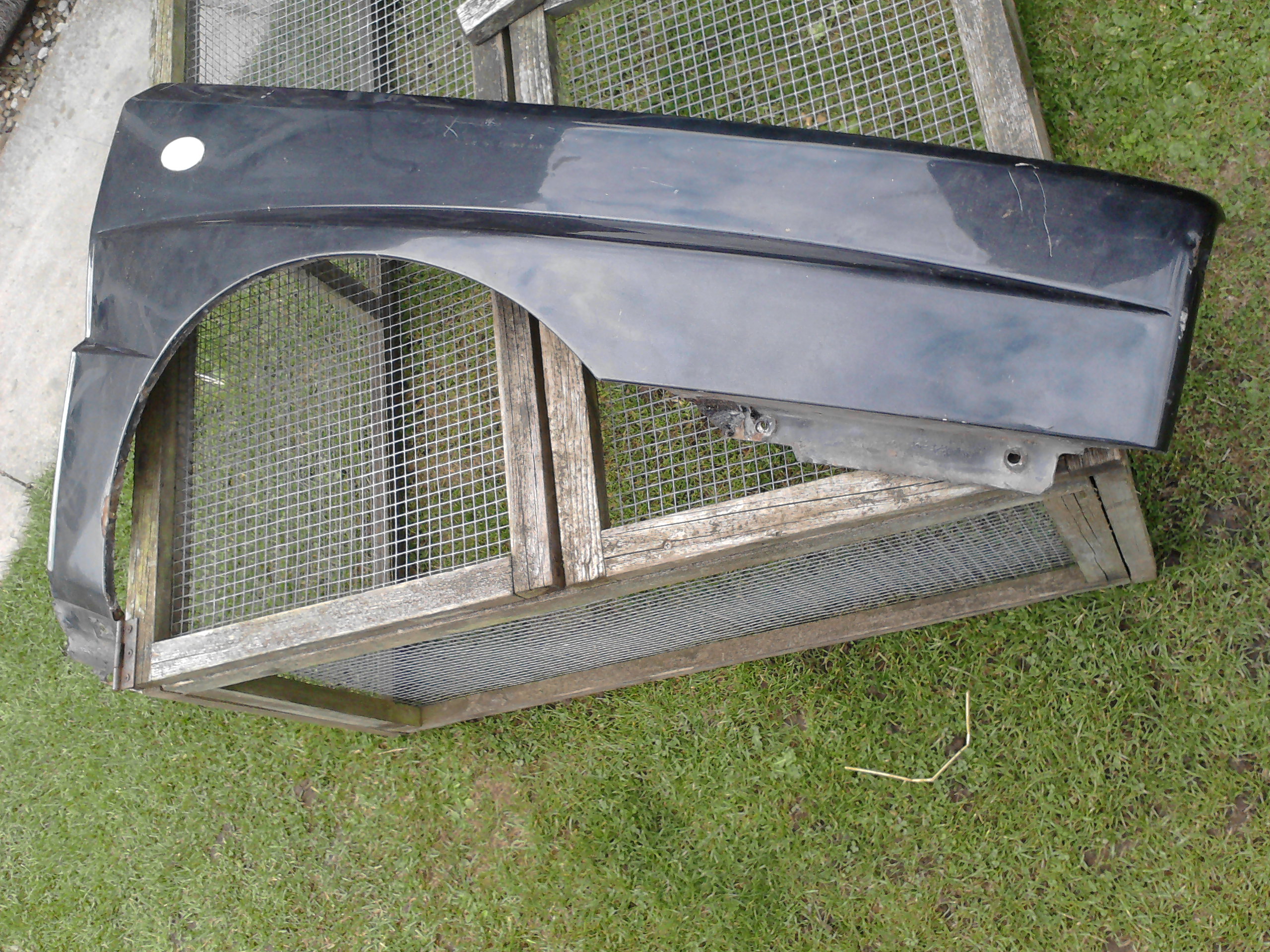

also picked up a very good drivers wing too whilst there. mine has some rot and a previous repair that may well reveal some further work so had it whilst i could

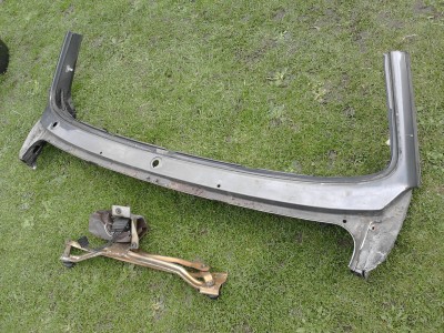

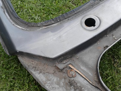

he also had an HF turbo there with a very good top scuttle panel that has no rot at both corners.
when asked could i have the corners from it he asked me has mine been converted to RHD wiper set-up.....soemthing i'd not thought of. the wipers on my car park on the right so drivers vision in rain wouldn't be the best.
swapping the whole panel over then fitting a RHD wiper linkage set makes perfect sense
especially as mine needs both corners repairing along with the wiper spindle holes
so we chopped the whole lot out!
amazingly the underside is in tip top condition, no rot around any wiper spindle or anywhere really.
i may pick off the spot welds and just fi the top portion but i've now got the option of fitting the good underside panel if it's needed too, once it's all out i can assess the situation.

best bit is the screen/scuttle panel JB ;)
