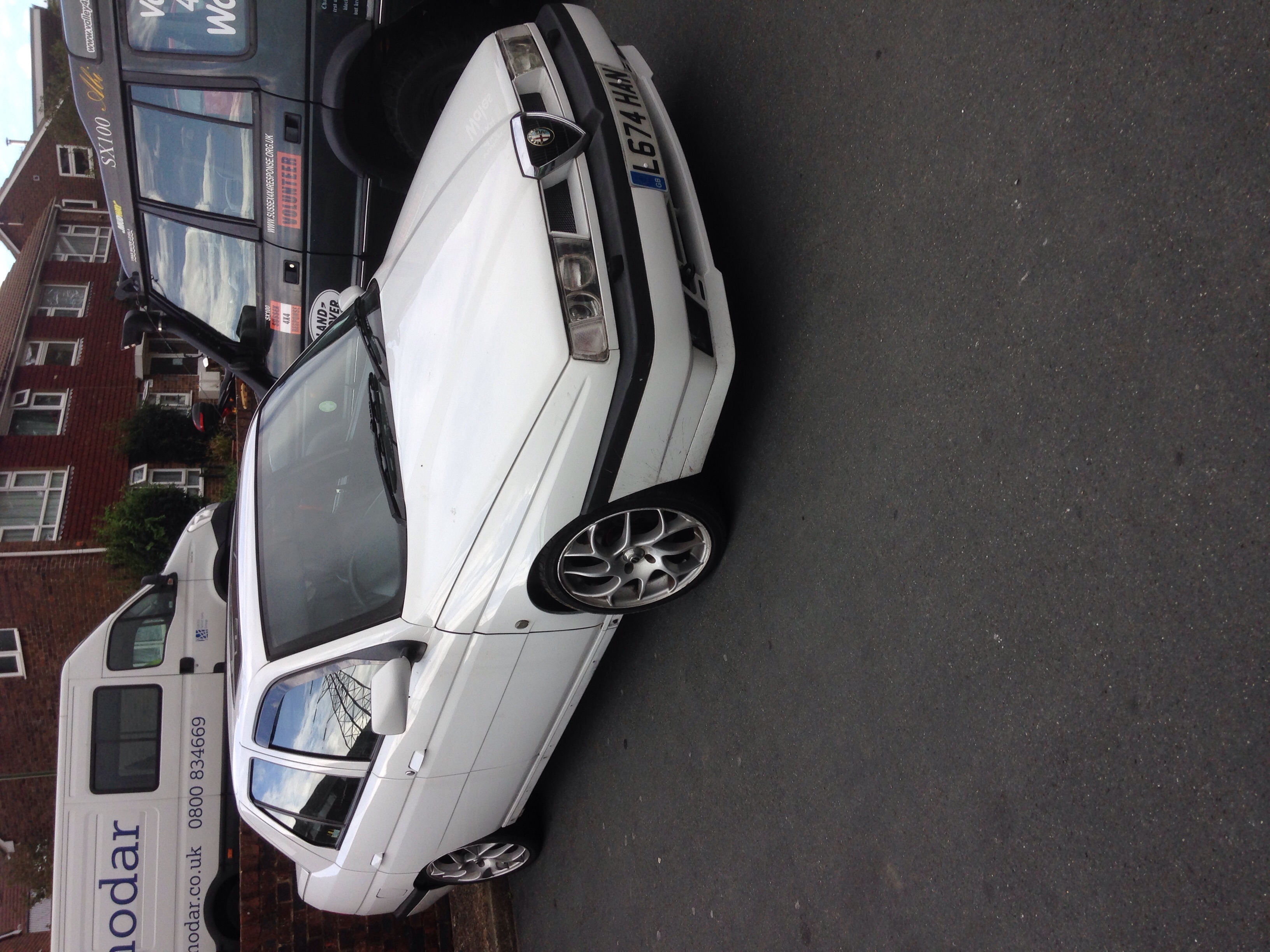

The white 155 will be getting the diesel engine from the lhd 155 diesel over the next few weeks
The shell has had all the welding done and a full respray
The vemons are for the girlfriend's mk1 golf cabby
More 2mor
