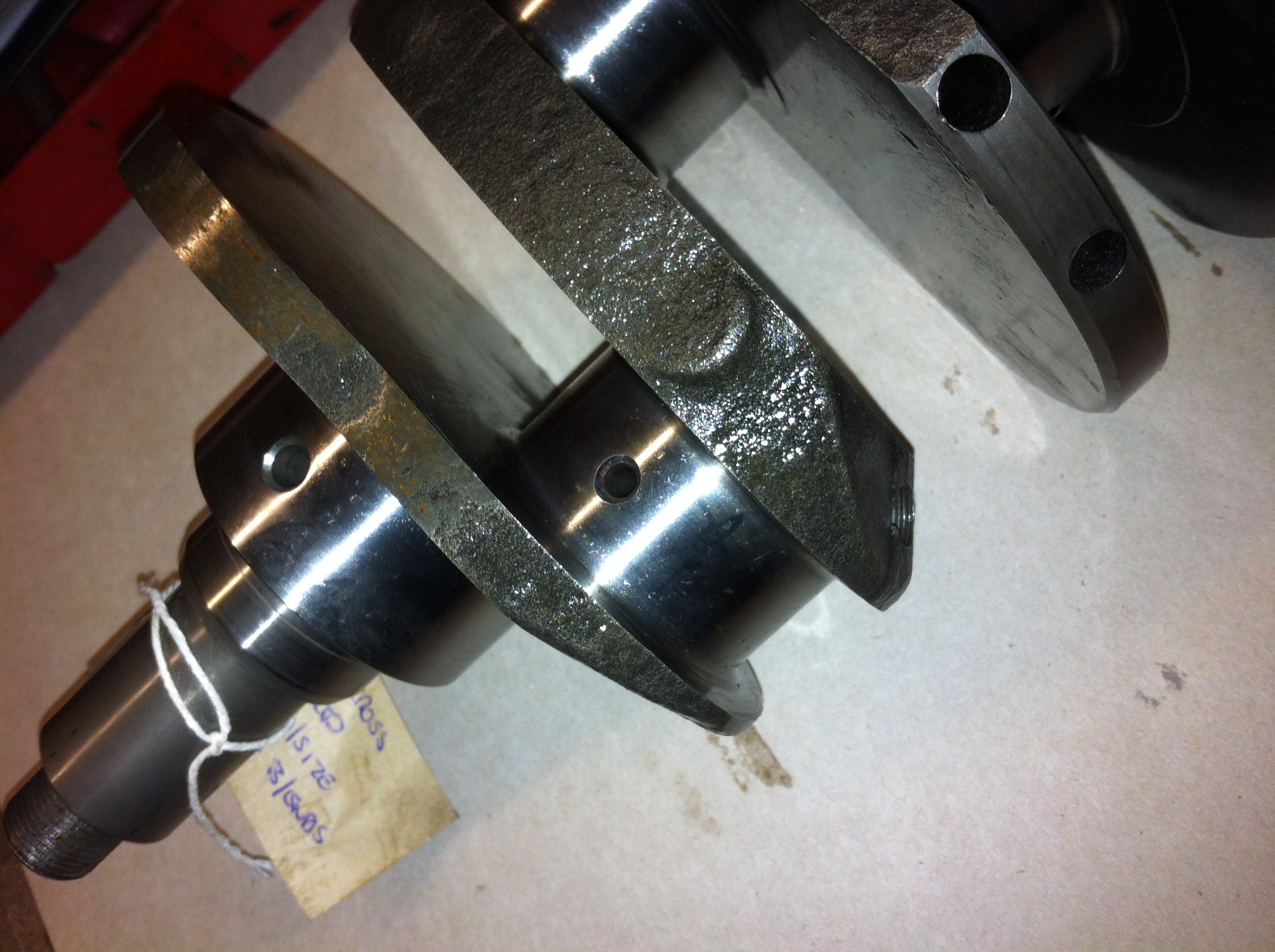

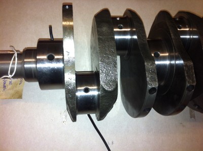

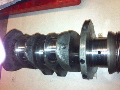

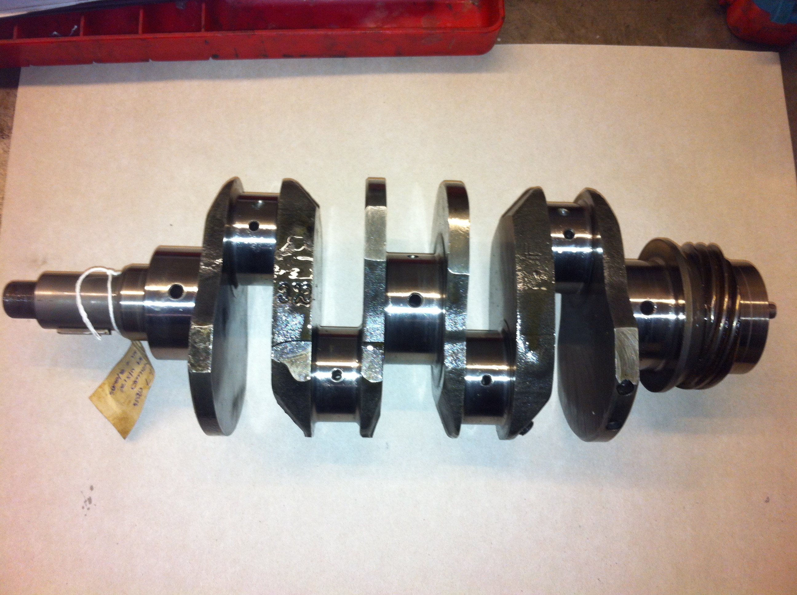

I've been in Lincoln and taken a few photos to help explain what we did on our non-steel cranks. We always used a stock 1.7 crank and had our cranks crossdrilled in a manner entirely different to the stock Alfa way!
The photos below shows one of our cranks. Looking at the left hand side of the crank, the standard Alfa drillings are those with the wire inserted. We left those unchanged, but crossdrilled each main and big end separately and then linked the main to the big end by drilling down through the web and picking up the crossdrilled holes. The ends of the drillings through the web were then tapped and plugged.
We use a new 16v oil pump, lap the pressure relief valve in carefully to ensure it seals and add a 1mm shim under the relief valve spring and also add restrictors in the block oilways to the cylinder heads to try and keep oil pressure back in the crank. The restrictors reduce the gallery size to 1mm.
The big end bearings were 105 series big end bearings as the material was better, but had to machine them down on each side as they are originally too wide. We would change them as a precaution after every 3rd race. We would also change crank thrust bearings at the same time. Mains would do a season. On the 16v we use Joe Gibbs XP6 race oil - its very good (but not cheap) - it wasn't available when we were running the 8v but we have run Ted's engine on it and will supply it for Simon's Trofeo. The technical advice we received on it would be that it definitely helps reduce wear.
