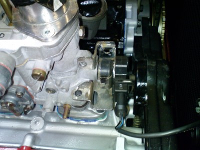

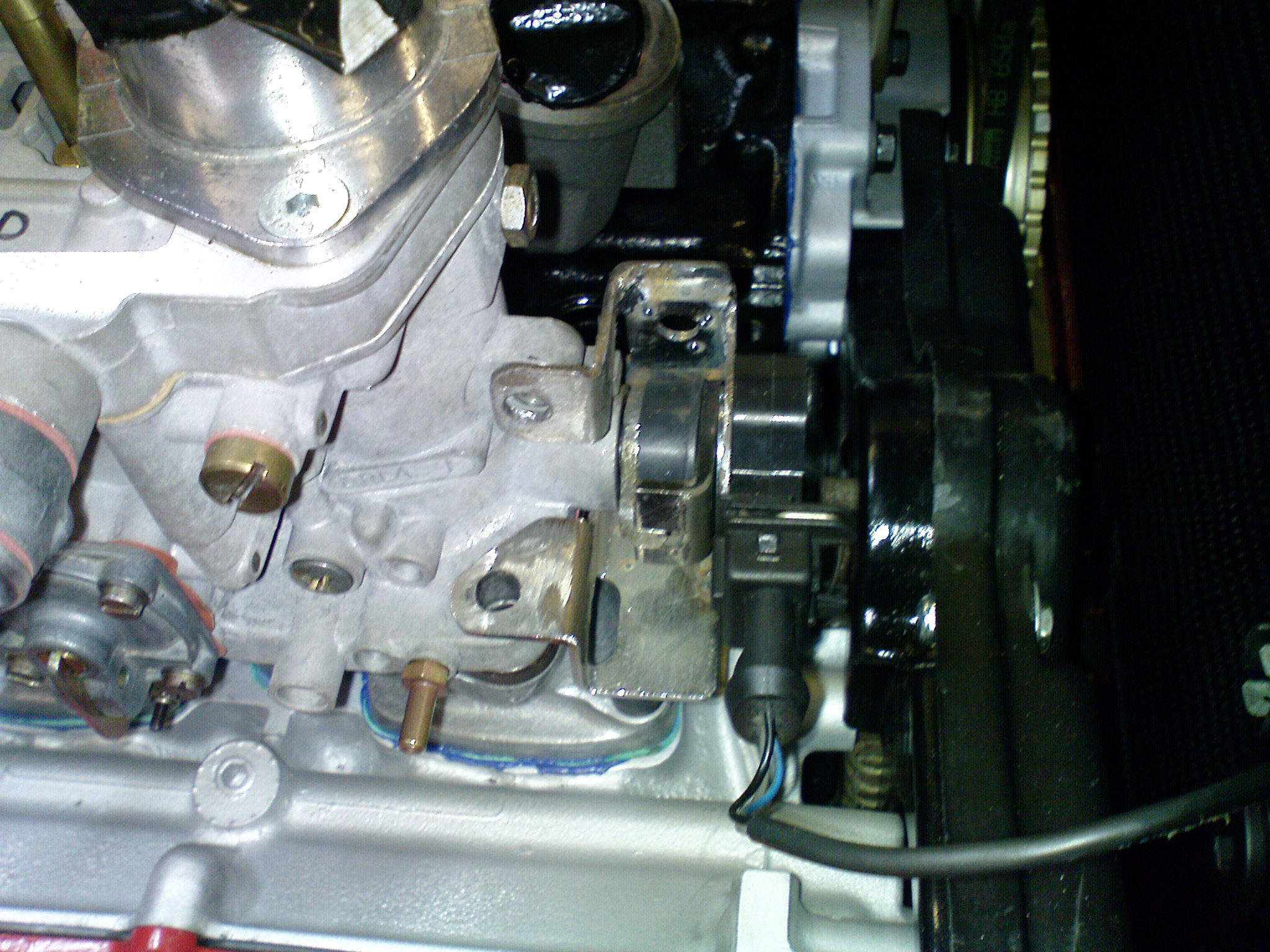

just catching up on this thread... I dont need a NoDiz kit for the sud but maybe at a later date for my GTV
anyways i can offer some tips on things mentioned in the thread
I did the 36 less one trigger wheel on my boxer to run with mega jolt, and made a little bracket to fit a throttle pot to the drivers side carb
have attached some pictures for ideas :O)
- Posts: 3046
Re: NoDiz vs Megajolt Ignition Control
thanks for that Kam.
thats pretty much exactly what you'll be doing i think H.
nice pictures Ta very much
