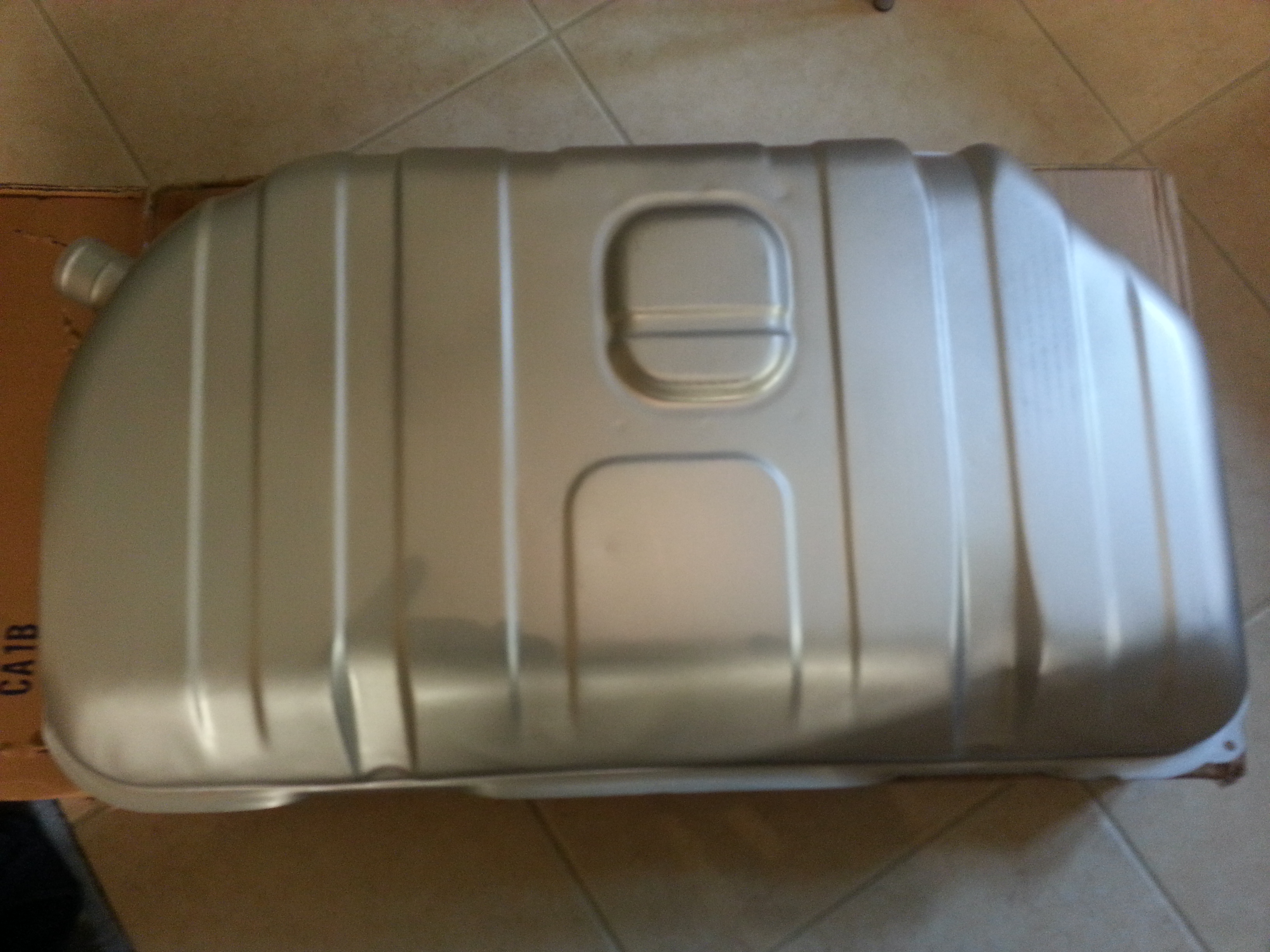

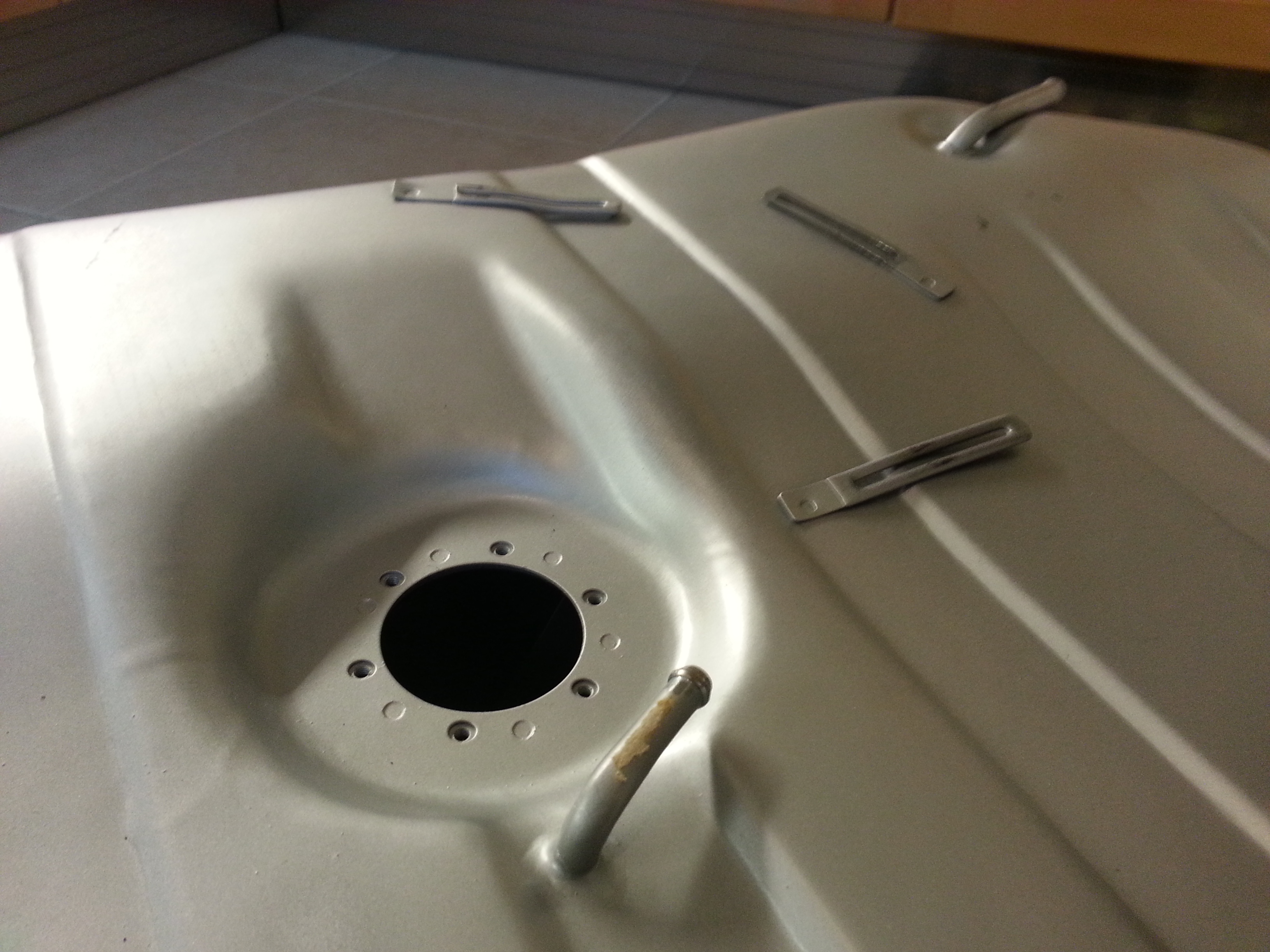

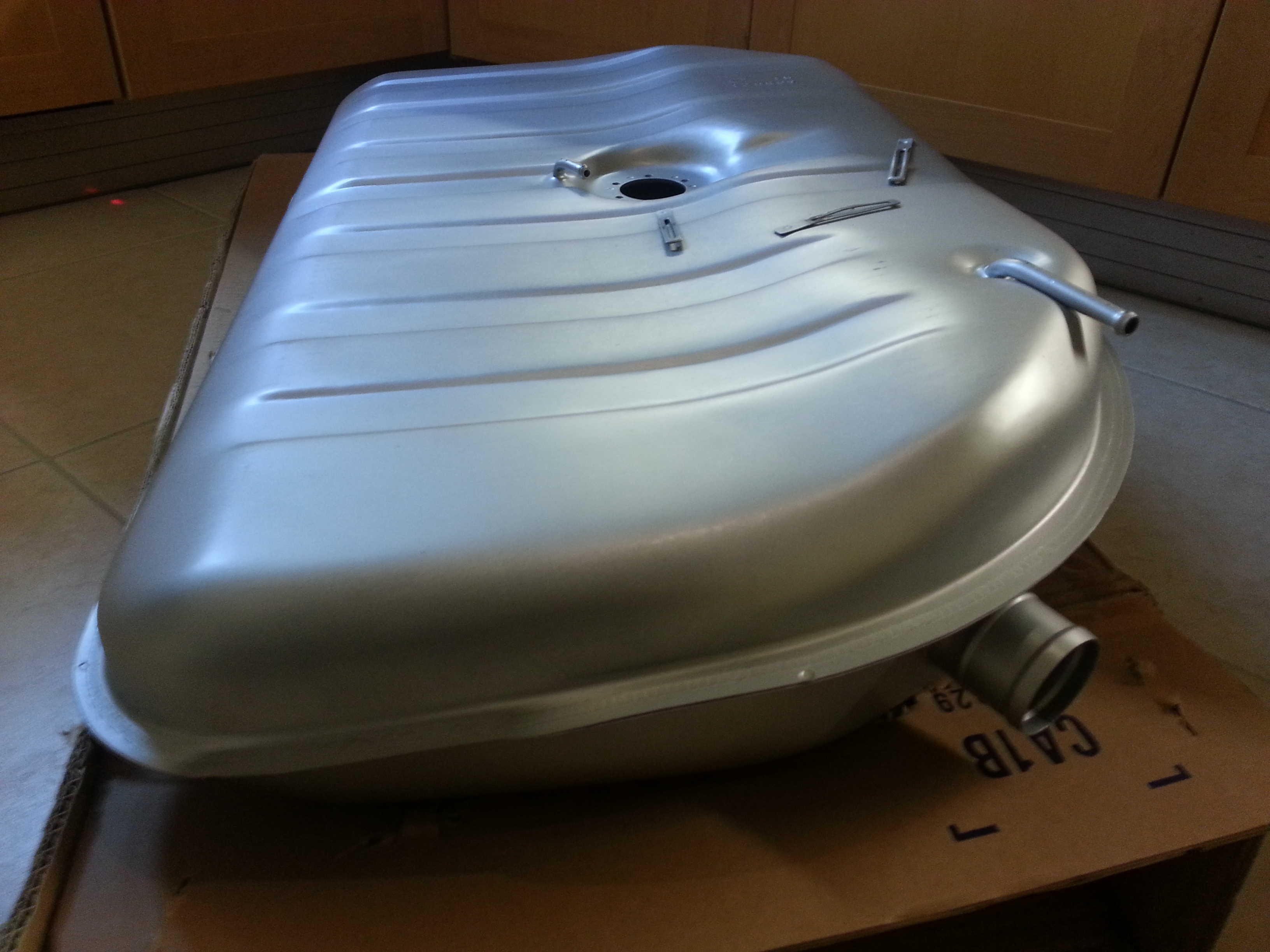

I have just taken delivery of one of these fuel tanks. Only ordered 3 days ago so very quick delivery. Paid £88.60 delivered UK, so a very good deal all in all :D
At first inspection it looks very good indeed. Factory fresh tank that just needs the additional vent outlet on the top side sealing off as it is not needed for a carb fed Sud like mine.
Here are some pics of the tank as unpacked today:

looks great, nice deal and very quick delivery.

Looks like a great tank!

Well, there is one less tank available now and only four left. Thanks Alfasam for the tip off as I need a new tank for my 'get it finished one day Sprint Veloce'. The new tanks must surely be made of better steel than the originals and are therefore excellent value for money. As for the extra vent. I fitted a late 33 tank to my Ti many years ago and simply put a T piece near the top of the vent pipe that runs up the outside of the filler neck and ran another fuel line to it. Helps when filling up.

I installed one of these under my 1982 Sud few years ago without a problem, capping of the extra line.

I'm using one on a 1980 sud ti.
I've got an old tank here,and the only difference seems to be an extra pipe near the sender on the new one.....just blank it off.
